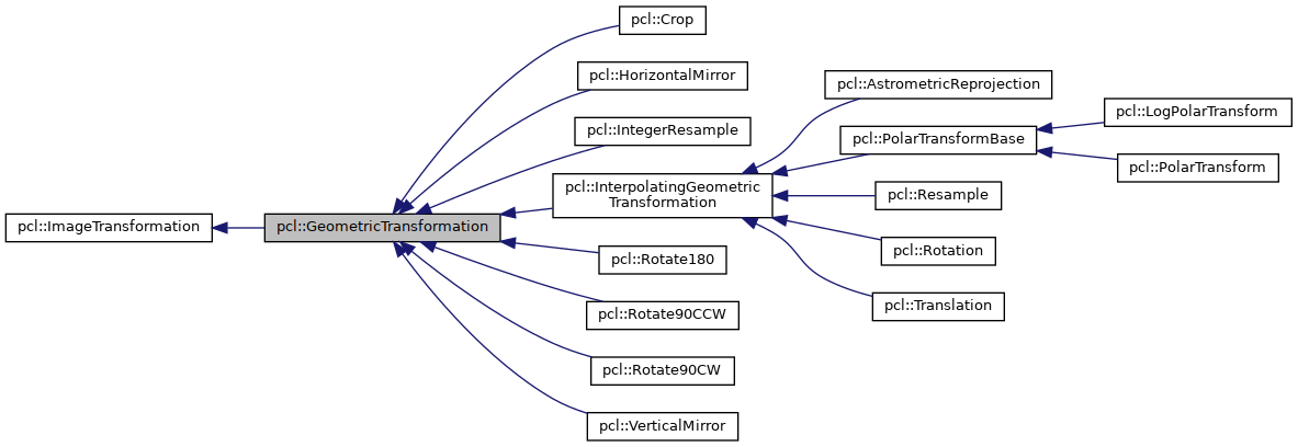

+ Inheritance diagram for pcl::GeometricTransformation:
virtual void GetNewSizes (int &width, int &height) const =0
GeometricTransformation represents a geometrical transformation that can be applied to any image type defined in PCL.
InterpolatingGeometricTransformation, ImageTransformation
