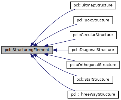

+ Inheritance diagram for pcl::StructuringElement:
