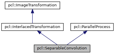

+ Inheritance diagram for pcl::SeparableConvolution:
