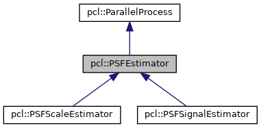

+ Inheritance diagram for pcl::PSFEstimator:
