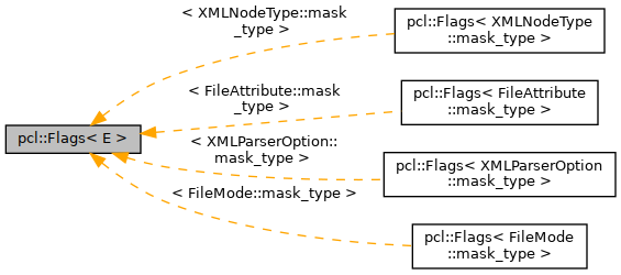

+ Inheritance diagram for pcl::Flags< E >:
