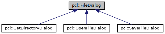

+ Inheritance diagram for pcl::FileDialog:

GetDirectoryDialog, OpenFileDialog, SaveFileDialog, FileFilter
