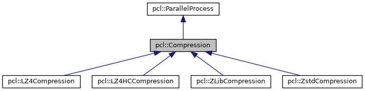

+ Inheritance diagram for pcl::Compression:

◆ SubblockSize()
size_type pcl::Compression::SubblockSize ( ) const
Returns the current compression subblock size in bytes.
See SetSubblockSize() for more information.
Definition at line 284 of file Compression.h.
◆ Throw()
void pcl::Compression::Throw ( const String errorMessage) const
protected
Helper function to throw an error message with inclusion of the algorithm name.
◆ Uncompress() [1/3]
ByteArray pcl::Compression::Uncompress ( const ByteArray compressedData,
size_type  uncompressedSize,
Performance perf = nullptr
Decompression of a compressed data block stored in a ByteArray object. Returns the uncompressed data as a ByteArray.
See the Uncompress( const subblock_list&, Performance* ) const member function for more information.
Definition at line 464 of file Compression.h.
References pcl::Compression::Subblock::compressedData, and pcl::Compression::Subblock::uncompressedSize.
◆ Uncompress() [2/3]
ByteArray pcl::Compression::Uncompress ( const subblock_list subblocks,
Decompression of a set of compressed subblocks.
subblocksReference to a dynamic array of compressed subblocks. The specified array should be the result of a previous call to one of the Compress() functions for this algorithm. This object must have coherent ItemSize() and ByteShufflingEnabled() properties to match the ones used when the data was compressed.
perfIf non-null, pointer to a Performance structure where performance data will be provided.
Returns the uncompressed data as a ByteArray object.
In the event of errors, such as invalid or corrupted data, uncompressed block or subblock size mismatch, or an out-of-memory condition, this function throws an Error exception.
Definition at line 447 of file Compression.h.
References pcl::Array< T, A >::Begin().
◆ Uncompress() [3/3]
size_type pcl::Compression::Uncompress ( void *  data,
size_type  maxSize,
dataStarting address of the output uncompressed data block.
maxSizeMaximum space in bytes available at data. Must be equal to or larger than the total uncompressed size.
Upon successful completion, the uncompressed data will be available in the specified output data block, and the function will return the length in bytes of the uncompressed data (necessarily smaller than or equal to maxSize).
In the event of errors, such as invalid or corrupted data, uncompressed block or subblock size mismatch, or an out-of-memory condition, this function throws an Error exception. In such case the data possibly stored in the output data buffer will be invalid.
◆ UncompressBlock()
virtual size_type pcl::Compression::UncompressBlock ( void *  outputData,
size_type  outputSize,
const void *  inputData,
size_type  inputSize
protectedpure virtual
Decompression of a contiguous compressed block starting at inputData with inputSize length in bytes. The uncompressed data will be written as a contiguous block starting at outputData, with length equal to outputSize. Returns the number of bytes written to outputData, which should be equal to outputSize, or smaller in the event of error.
◆ Unshuffle()
static ByteArray pcl::Compression::Unshuffle ( const uint8 data,
size_type  size,
size_type  itemSize
inlinestaticprotected
Reverse byte shuffling algorithm (or unshuffling) applied to size bytes starting at data, with element length itemSize in bytes. Returns the unshuffled data as a ByteArray object.
Definition at line 550 of file Compression.h.
References pcl::Array< T, A >::At().
