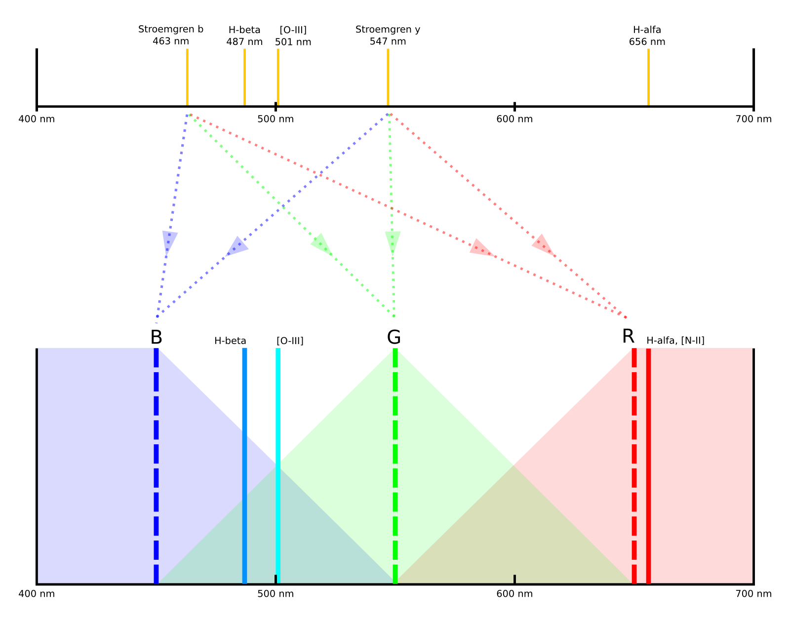

Most data in this image were obtained with the reflecting Zeiss telescope of 1.23 m at Calar Alto Observatory, in official time of the Andalusian Network for Technical and Scientific Public Outreach (RECTA), through an agreement with the Documentary School of Astrophotography (DSA). Some data come from the 2.2 m and 3.5 m telescopes placed at the same observatory. Images with different integration times were obtained with filters Strömgren b, H-beta, O-III, Strömgren y, and H-alpha, completing 300 minutes as a whole. The information from those filters was distributed among the three color channels (blue B, green G, red R), as indicated in the attached figure. Strömgren data were used to compute the fluxes of continuum emission at wavelengths of 450, 550 and 650 nm. Also, each emission line was assigned a concrete color hue. The image was processed by Vicent Peris, José Luis Lamadrid, Jack Harvey and Steve Mazlin with the program PixInsight.

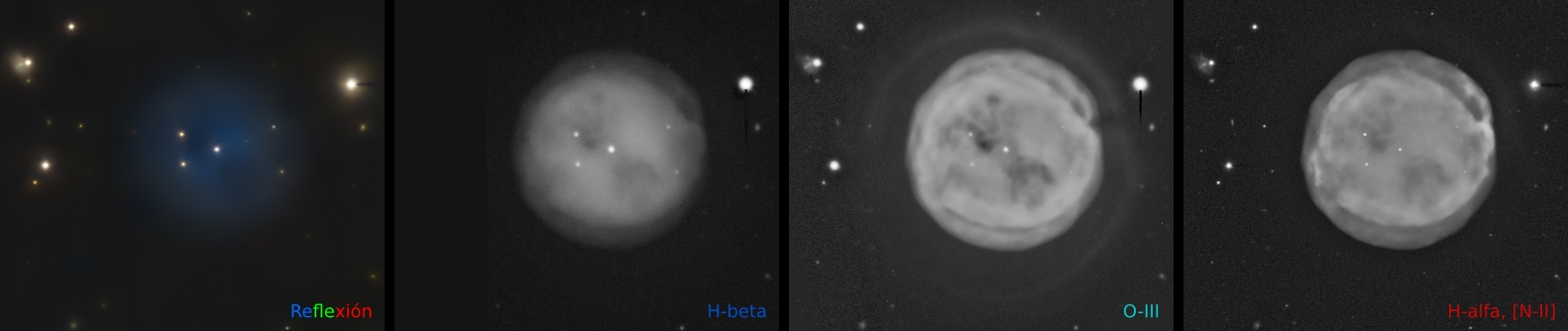

The diversity of filters used allows to disentangle different contributions to the light emitted by the nebula. Some areas shine with reflected light, while others are dominated by hydrogen (H-α, H-β) or oxygen (O-III) excitation, depending on the physical conditions at each area inside the object.
Contributions to the nebular shine from reflection and emission mechanisms in several spectral lines. Click the image to see a larger version.

Filters used to obtain this image and their distribution among the three color channels B, G and R. Click the image to see a larger version.
