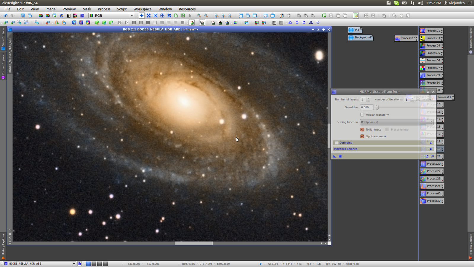

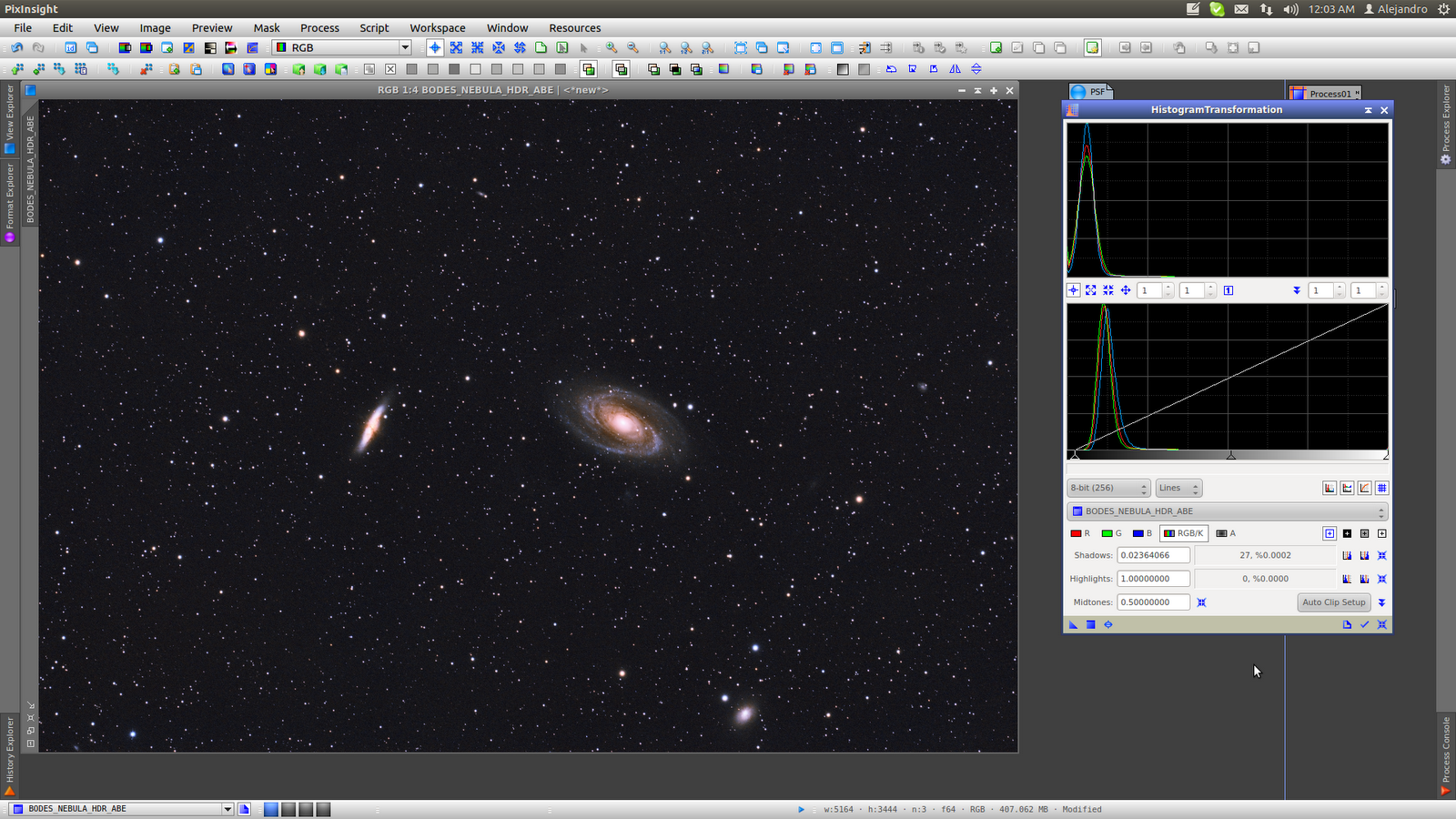

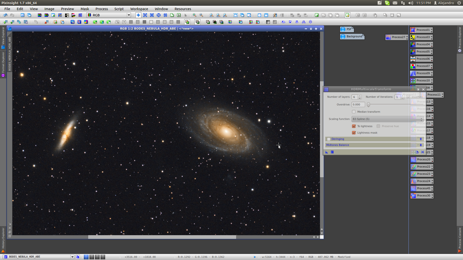

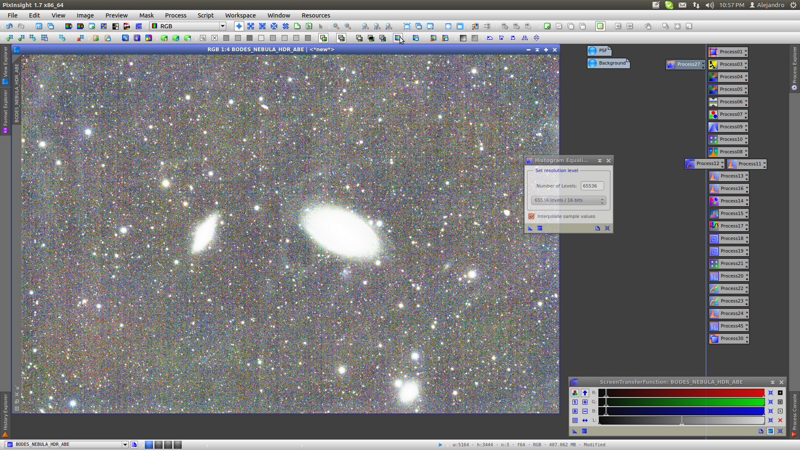

Hi Sedat, this my attempt
First a small crop to eliminate black borders
HE let you see what happens in background. There are gradients and vertical lines.
ABE
DBE
There are still vertical lines
For vertical lines rotate 90º and apply CBR
Rotate 90º back and new DBE

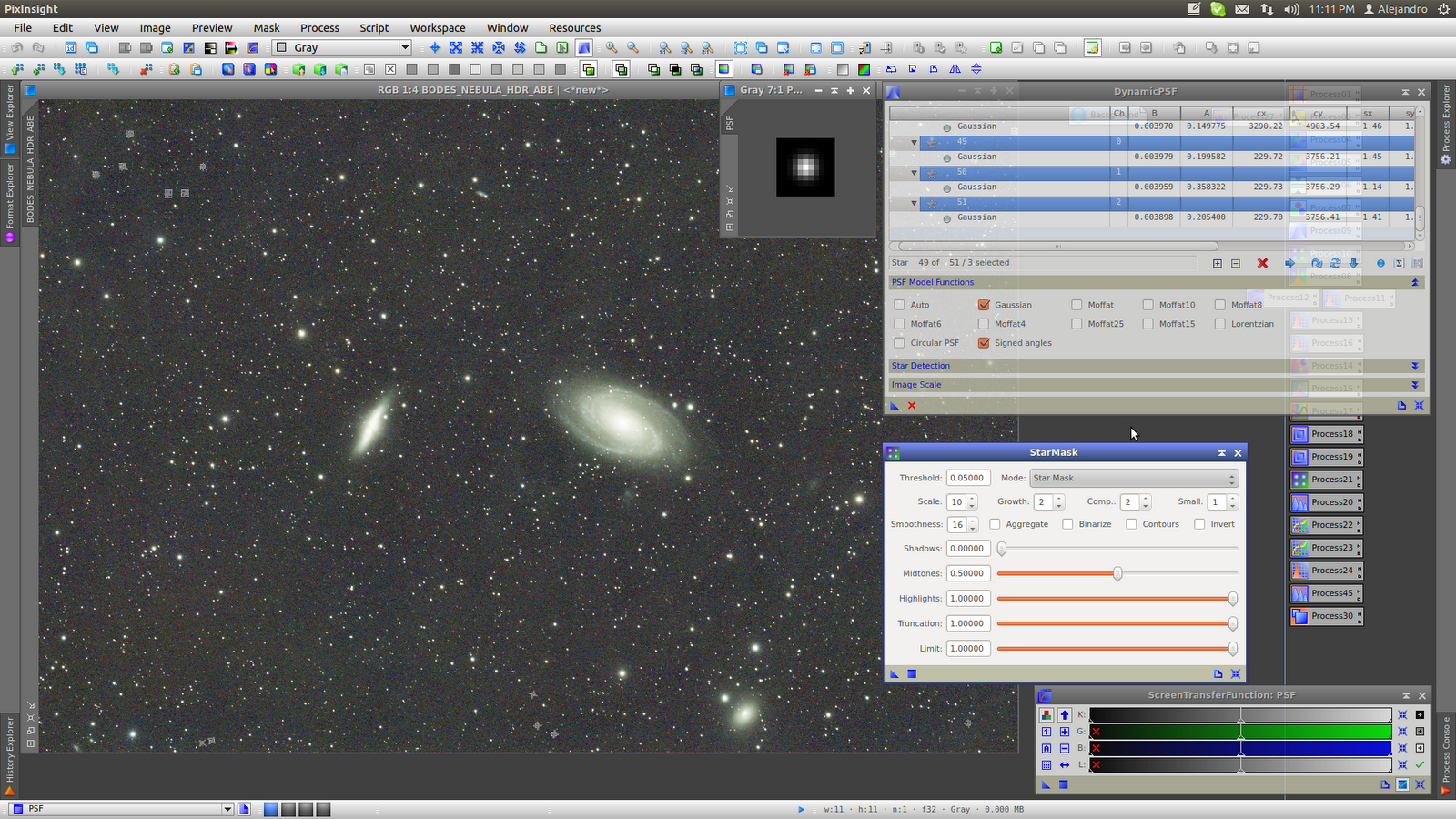

Whit AberrationInspector create a new image to be used as Reference image in BN
With AberrationInpector create a new image to be used as Reference image in CC and a preview of the galaxy as Reference image
Generate a PSF and a Star Mask to be used in Deconvolution, apply protecting stars with star mask.
HT
Generate a LMask
Apply SCNR (without mask)

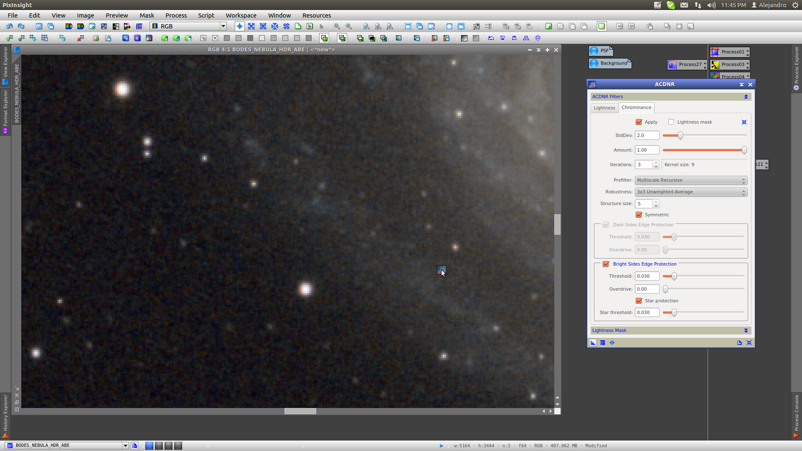

Apply ACDNR to Chrominance (without mask)
ColorSaturation with LMask protecting background
HDRMT
HDRMT
New starmask to be used with MMT
MMT protecting stars with starmask
CT
CT protecting background with Blue channel
HT
MMT
Final image:
Full image:http://endor.uv.es//data/public/ce7867e95bfd2f127f952513eba96932.php?lang=en

Wow that's a nicely visulaized workflow with a very nice Endresult  :D
Why did you only ACDNR on your Chrominance? Is there a reason for it because I saw this already several times in peoples processing..

Hi Lex, good to know the work-flow is easy to visualize.
When there is only background, without nebulosity, I try to use noise reduction tools as less as possible. In this case chrominance noise is important and after saturation would be even more evident but ligthness noise seemed to be well.
