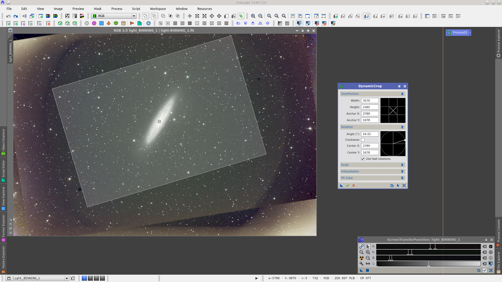

I couldn't have a good set of flats, so the integration was not as good as expected. Even can be seen a couple of dust spots.

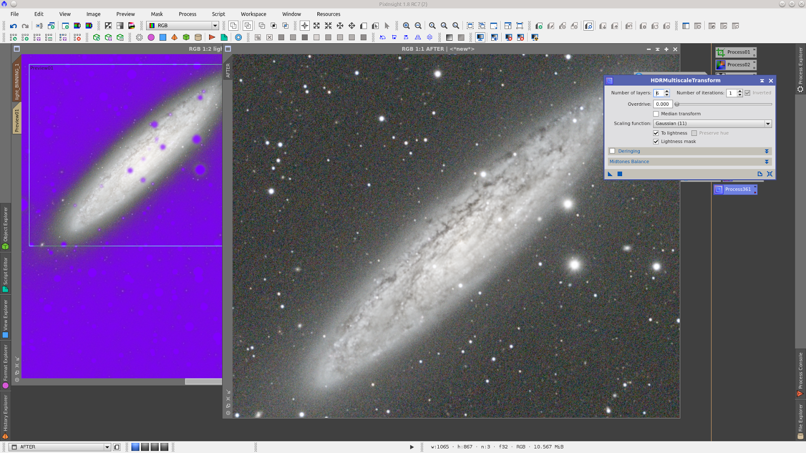

In the processing I would try to highlight the fine luminosity that is seen in the periphery of the galaxy. See the area showed with previews.
First a crop using DynamicCrop
DynamicBackgroundExtraction placing the samples carefully, to avoid placing it over the stars or in the galaxy halo that I want to preserve
With AberrationInspector create a mosaic of 4 panels and use it as reference image in Background Neutralization Tool
Generate a new mosaic with AberrationInspector for using as Reference image of Background Reference and a preview that include the galaxy for using as Reference image of White Reference in ColorCalibration Tool
Open the DynamicPSF tool and generate the PSF to be used in Deconvolution.
With star mask generate a mask to protect the core of the big stars when applying Deconvolution and to be used as Local support of Deringing
Apply Deconvolution to increase subtle details in the structure of the galaxy and make stars more puntuals
Apply the ScreenTransferFunction to the image by moving the blue triangle to the control bar of HistogramTransformation Tool
Build three masks to be used in different process. A range mask, an starmask and add both to have another to protect stars and background at the same time.
HDRMultiscaleTransform for increasing details in the galaxy

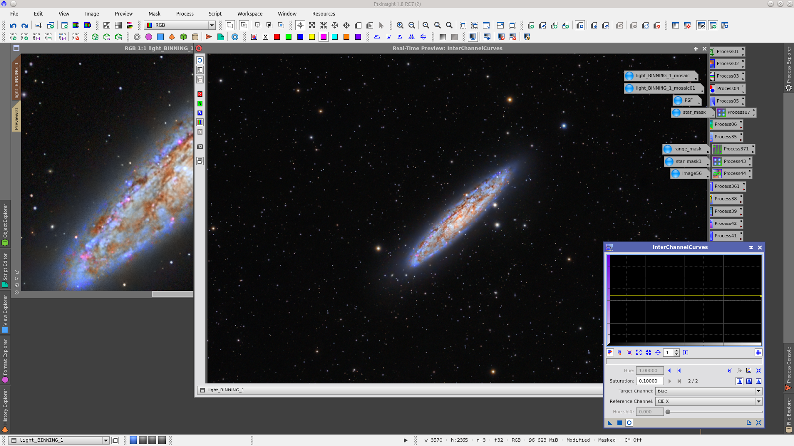

Increase contrast with InterChannel Curves using the Hue as Reference Channel and the CIE c as Target Channel
Decreasing the background a little more with Gamma Stretch
InterChannel Curves again to reduce the Cyan in the galaxy, protecting background and stars with Image56
