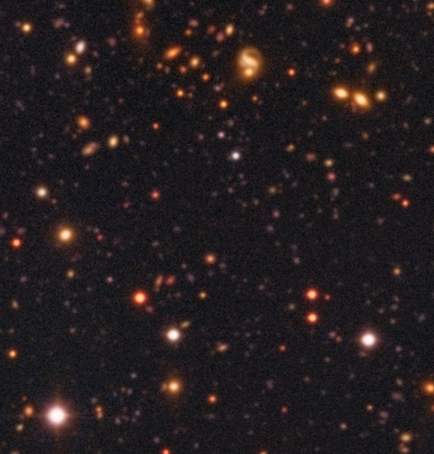

The image 644 has some background information that does not seem to be a pattern of the camera and I assumed that they are not clouds, perhaps a wrong assumption. If so, the following is not all valid.  :-\
What I did was a combination, only the sum, of:
B = 365 +396 +427 +458 +489
G = 520 +551 +582 +613
R = 644 +675 +706 +737 +768 +799 +830 +861 +892 +923 +954 + H + K + J
For the combined image:
ABE
DBE
HT (STF)
ACDNR to Crominance
SCNR to green
After that I separated the stars and created a mask from the background image 644.
With the mask protecting the background in the main image applied InterChannelCurves with target in CIE L and  CIE C and the reference channel in green.
After that, in the same image without stars:
LHE
CurvesTransformation
CurvesTransformation to stars with Lmask.
PixelMath to add stars again
Erosion (a little bit)
SCNR
The result was too noise...
Crop 1:1
Then I built a luminance with the integration of all images. No rejection
MMT
HT (STF)
LHE
And combine with the image.
ADCNR to Crominance
I tried to "repair" the defects in the bottom left corner with masks made over the ones that had the defects (520 and 635) and applying HT
The final:
Crop 1:1
Saludos. Alejandro.
