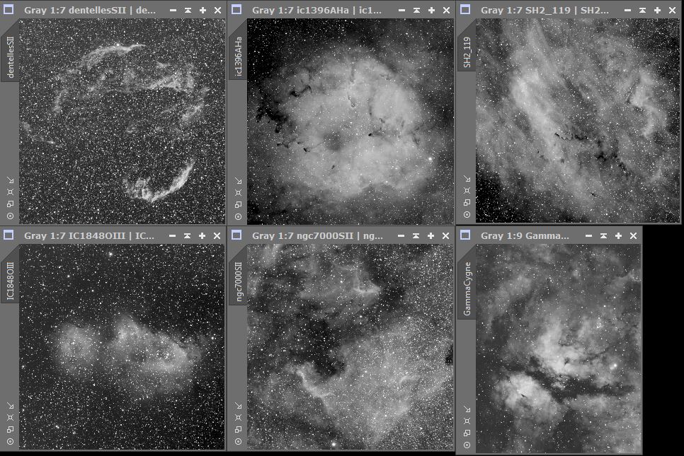

What we need now is more data to test the tool. If you can upload an image, I'll be glad to make an example and post it here.
Thanks Juan, I will prepare you some linear monochrome images  8)

Hi Juan
I sent you by email the link for these 6 linear images taken with my setup. THis is preprocessed integration.
I think they are typicaly what we obtain on deep sky nebulas objects with a CCD camera.
Most of them have very low light signal and moderate noise. Some have higher signal and noise.
The goal is to REDUCE (not REMOVE) the noise AND preserve maximum of the details.
TGVdenoise is a powerfull process but, as always, the job must be done during the acquisition (exposure time, number of exposure, tracking, preprocessing quality). I will not process a very noisy image.
thanks
Philippe
