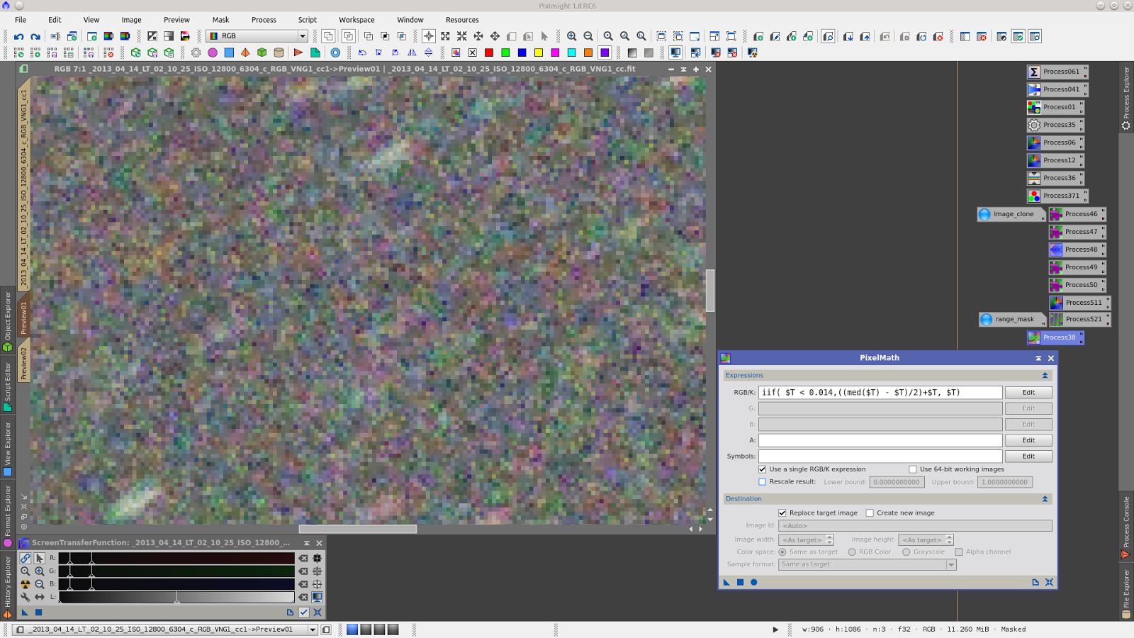

Now the key cuestion here is generate a mask that allow to process the sky without afecting the mountains and viceversa.
For that I clone the image and apply consecutivelly Morfological transformations and smoothnees with ATWT until have a good diferenciation between sky and mountains that allow range mask to generate what I am looking for.
Now I will work protecting the mountains. First apply the formula to elimiante darks holes.
Transfer STF to the HT tool and apply
Noise reducction: to green
Chrominance noise reduction in big scales
Saturation with CurvesTransformation
Noise reduction in one pixel layer using MultiscaleMedianTransform tool
Chrominance nose reduction in  layers from two to eight pixels
A little more contrast with ATWT
Curves to correct colors (a and b)
Exponential transformation to smoothnees the background
Now I need a more located chrominance noise reduction, for that I will generate a mask that protect at the same time the mountains and the brigh part of the sky.
Extract Luminance, invert and apply curves and ATWT to smoth a little
Then, with PixelMath add the luminance and the previous RangeMask
Now apply chrominance noise reduction in the background
Protecting now the sky with the first range mask, apply HT to the mountains (Transfer the STF to the HT tool)
Reduce red in the sky protecting the mountains.
Noise reduction to smooth the background using ACDNR
Rotate 90° Counter-Clockwise and resample
Add signature
