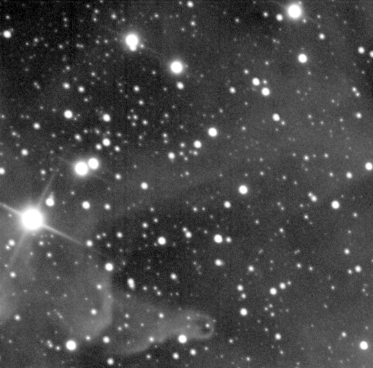

New challenge, now with real world data:
This is a crop of CCD data, green filter, already stretched, but no further processing. This corresponds to an integrated and calibrated master light.
Good luck!
PS: Alejandro, clever approach. I played with your icons. It seems that a soft threshold yields a bit better results, in ATWT. Also, the first two processes of your chain worked quite well with this new challenge, but the third failed completely.

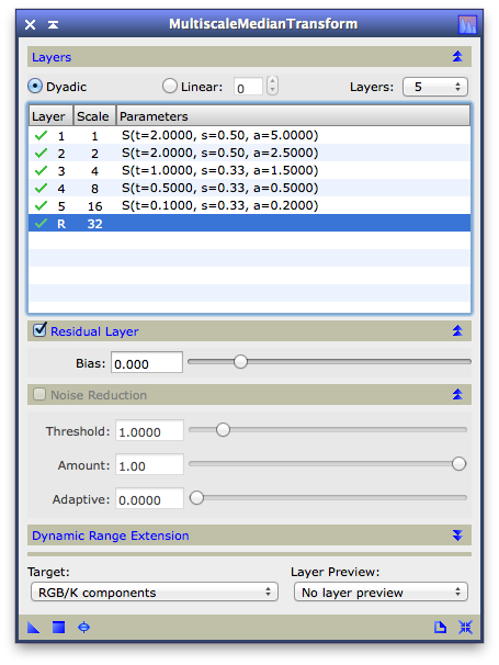

Hi Carlos
Here is your original image :
Here is my processed version
I wanted to preserve maximum details, I used MMT with your original image as a mask :
a blink is interesting to do to compare 2 images.
cheers
