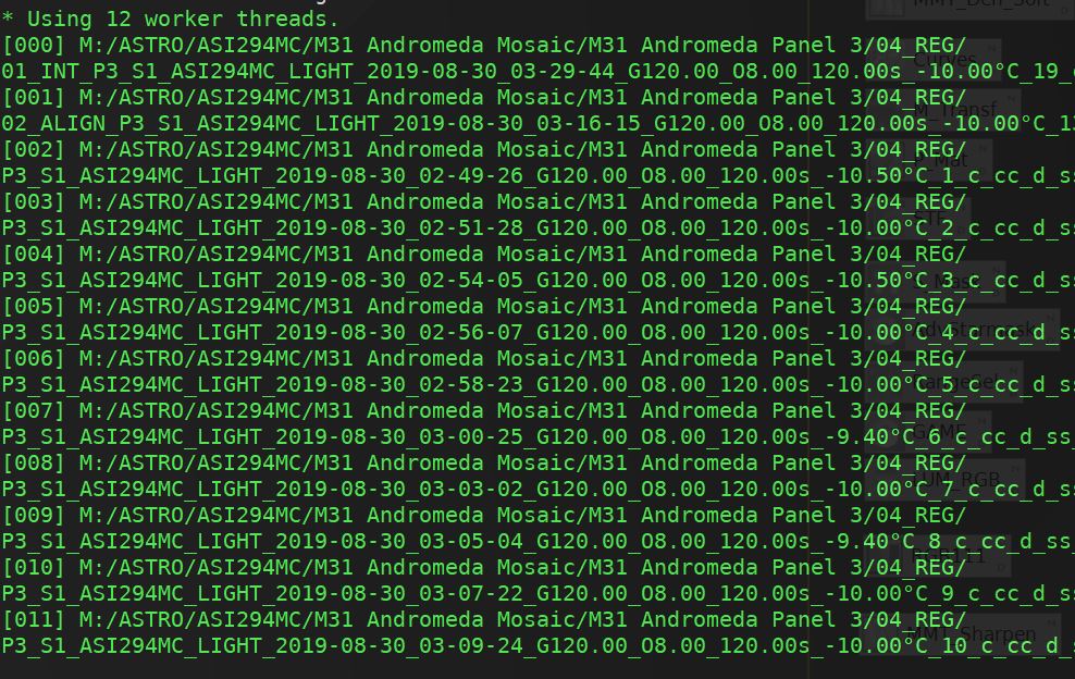

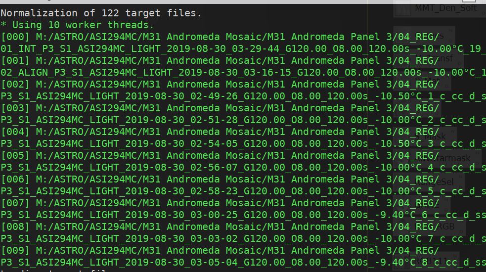

I have the same problem, I have crashes with LocalNormalization and Drizzle Integration, 150 frames
I am running PI on an i7 8700k with 12 logical processors.
It's a desktop PC with water cooling, max temp is 80°C at full load
One thing I have noticed when I launche LN the console shows "13 threads" instead of the standard 12
I will try limiting the threads to 10
I can share my dataset if needed

Limited to 10 cores, console shows 12 working threads, crashing
Limited to 8 cores, console shows 10 working threads, it works through the end
 I believe some optimizations are needed , hopefully I didn't buy this PC to run it at reduced potential...
