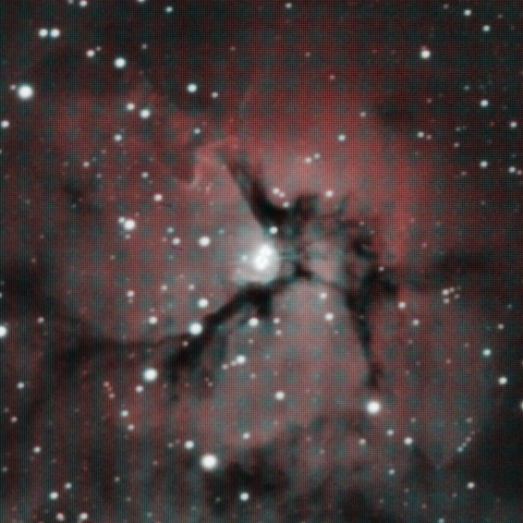

I've rent time on  remote telescope and so I've in my possession some FIT files already calibrated. These files comes from an SBIG ST-2000 XCM (CCD color camera).
So the FIT files are "bayer" (CFA image ?)
In PI after doing the "debayerization" with (the BatchDebayer script), I've done (with success) the star alignement and integration.
But the image looks a strange pattern
For tests, I've done the bayer conversion after alignement and integration and I've the same result !
Where I'm wrong in my process ?
Thanks a lot

Looks like debayering didn't work well for your images. In the Batch Debayer script, are you sure you're using the correct Bayer mosaic pattern for your images?
When reading your replay I've try all the bayer mosaic and for GRBG, the result is OK ... thanks a lot.
