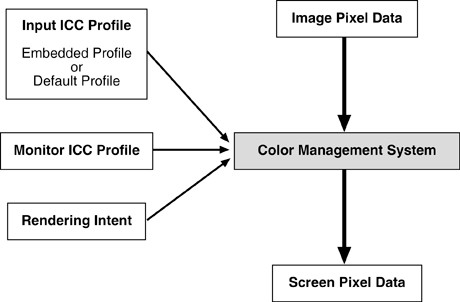

For consistent representation of color on your monitor, PixInsight applies a color transformation each time a pixel is drawn on the screen. This color transformation requires accurate characterization of input and output devices through ICC profiles.
On startup, PixInsight looks for the ICC profile currently assigned to your monitor in your Windows installation. By default, monitors are assigned the sRGB color profile in Windows. PixInsight by itself will not let you change the monitor profile. To assign a particular ICC profile to your monitor, you should perform a monitor calibration by using a third party calibration hardware system and/or specialized software, or by simply installing the ICC profile that came on a CD with your monitor —though this last option is often as inaccurate as just doing nothing.
Input data must be characterized by specific ICC profiles. For a given image, the input profile can be embedded in the source image file, or it can be assigned a default profile if the image is untagged or if you don't want to use the embedded profile for some (hopefully well founded) reason. Input profiles can correspond to physical devices and also to device-independent color spaces such as Beta RGB, Adobe RGB or CIE RGB, which are commonly used to work into wide color gamuts. Anyway, PixInsight will always be using a simple color transformation, which can be schematized as follows:
Image pixel data correspond to actual pixel values in the image. Screen pixel data are pixel values once transformed from the input ICC profile space to the output monitor color space. A rendering intent is a transformation strategy to try the color rendition that best matches a color reproduction environment such as photographical imaging, printer proofing or artwork graphics.
With the above management system, colors that you see on the screen will match as accurately as possible the true colors that an image's pixel values are intended to represent.

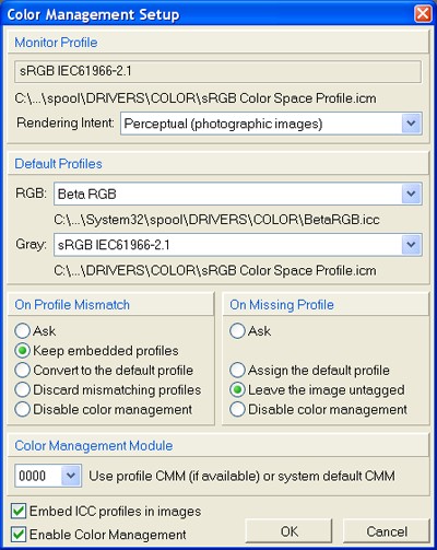

The Color Management Setup dialog box is where you define operative parameters of PixInsight's color management system. By selecting appropriate ICC profiles and other options, you tell PixInsight how to manage color to meet your needs. This dialog box can only be accessed through the Edit > Color Management Setup main menu option:
Monitor Profile
This panel shows the file path and description for the ICC profile currently assigned to the monitor in your system. You cannot change the monitor profile in PixInsight because PixInsight is neither a monitor calibration application nor an operative system, and letting you specify a profile for a device without calibrating it would be too naive.
The Rendering Intent list box lets you specify a transformation strategy for screen color rendition. For normal astrophotographical work you'll want to keep the default perceptual rendering intent, which should be the best option for photographical images.
Default Profiles
Here you can select the ICC profiles that will be used for images that have no particular ICC profile assigned. Such images are known as untagged images. Untagged images can be image files that have no embedded ICC profile or files that have embedded ICC profiles you don't want to use.
For an ICC profile to be accessible to PixInsight, it must be correctly installed in your system. In other words, PixInsight will ignore any ICC profile that is not located on the Windows standard profile folder. To install a profile, follow the instructions given by the profile creator and/or your Microsoft® Windows documentation —right clicking it and choosing Install usually does the job.
There are two default profiles, namely one for RGB color images and another one for grayscale images.
ATTENTION: PixInsight can use RGB ICC profiles for both RGB and grayscale images. This is correct in terms of color transformations, but it is a nonstandard practice that most image processing applications don't support. When a RGB profile is assigned to a grayscale image in PixInsight, color transformations for that image work by considering it as a RGB color image whose individual RGB chanels are mutually identical. Be aware that PixInsight will let you embed RGB ICC profiles in grayscale image files, but then you may have trouble when opening such files with other applications.
Profile Mismatch Policies
When you open an image and it does not have an embedded ICC profile, or if the embedded profile is not the default one, what should we do? You can tell PixInsight exactly what to do.
On Profile Mismatch refers to images that embed profiles different from the default profiles you have selected on the Color Managemen Setup dialog. When you open such an image, what PixInsight does depend on the option you have selected:
  • Ask — PixInsight will ask you what to do through a secific dialog box, where available options include the rest of choices you have listed here.
  • Keep embedded profiles — The embedded profile will be used for color management transformations. This is the default and most advisable option.
  • Convert to the default profile — Numerical pixel values are converted from the embedded source profile to the default profile, then the embedded profile is discarded. Select this option if you are absolutely sure of what you are doing.
  • Discard mismatching profiles — Ignore the embedded profile and manage pixel values as if they were defined in the default profile space. Sounds simple, and dangerous...
  • Disable color management — This option will cause PixInsight to throw pixel values directly to the screen for this image. Not recommended.
On Missing Profile is for untaged images, that is, images that don't have an embedded ICC profile:
  • Ask — Same as before. A dialog box will ask you what to do before opening the image.
  • Assign the default profile — This causes a copy of the default profile to be assigned to the image. The image will behave as if the default profile would have been embedded in the original file. If you save the image, the default ICC profile will be effectively embedded.
  • Leave the image untagged — Pixel vales will be assumed to be in the default profile space, but no more assumptions will be made. This is the default option.
  • Disable color management — As before, we cannot recommend you to do that.
Color Management Module
Windows' ICM 2.0 is a modular system. Third party color management modules (CMM) can be installed in your system to replace the default color management engine provided by the operative system. If you have a CMM installed, it should appear here and you can select it. If not, better don't mess with this.
Embed ICC Profiles in Images
When this option is selected, ICC profiles are embedded by default when saving image files to disk. However, when you use Save As to save an image, a dialog box with format-specific options is shown, where you always have an option to disable profile embedding prior to saving.
If you are working in the sRGB space for WWW production, you probably don't want to embed the standard sRGB ICC profile to waste 4 KB in every file you save. In fact, embedding the sRGB profile for images that are to be distributed on the WWW is strongly discouraged, since sRGB is the de facto standard space for the web.
Enable Color Management
When this option is not selected, color management is globally disabled in PixInsight. ICC profiles assigned to images are simply ignored, and pixel values are directly sent to the screen.
Of course, this option is selected by default, and we must ask you to leave it this way unless you have a really good reason to do otherwise.

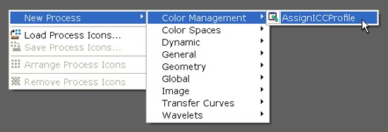

The AssignICCProfile process has been included in PixInsight 1.0 to perform profile assignment and conversion operations. You can instantiate this process as a process icon by right-clicking on the main window's background and selecting the appropriate item under New Process:
AssignICCProfile cannot be executed on previews, neither can it be executed globally.
