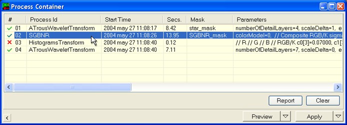

The Process Container Window
This window is the standard interface of ProcessContainer, but it is not the only interface for this process. The Processing History window is also an interface for ProcessContainer, but it can only work with a view's processing history, not with independent ProcessContainer instances (as process icons, for example). Another difference between both windows is imposed by the fact that a view's processing history is a read-only object, while an independent ProcessContainer instance can be freely edited.
On the Process Container window you have a list with the process instances owned by the ProcessContainer object currently loaded. Remember that processing windows in PixInsight work with copies of process instances, not with references to actual objects. This means that you can load a process icon in this window and play with it without being worried about making changes to the original.
Each process instance can be enabled or disabled. Disabled instances will be ignored when the ProcessContainer object is executed. This is very useful to try out a processing sequence and see what happens if we don't include some particular processes. To enable or disable an instance, just double click on the first column of the list. For example, the third process in the above screenshot was disabled.
The rest of columns are quite straightforward. Process Id gives the process identifier for each process instance in the list. Start Time can be blank if a process instance has not been executed yet. Secs. gives the execution time, if applicable. Mask is the identifier of the image used to mask each process, or it is blank if no mask has been used. Finally, Parameters shows a brief summary of the parameters used by each process.
