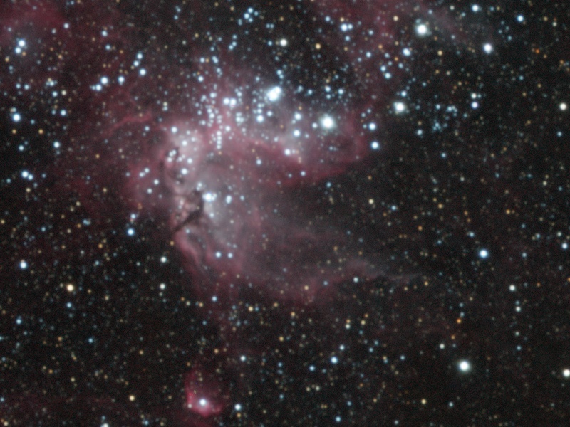

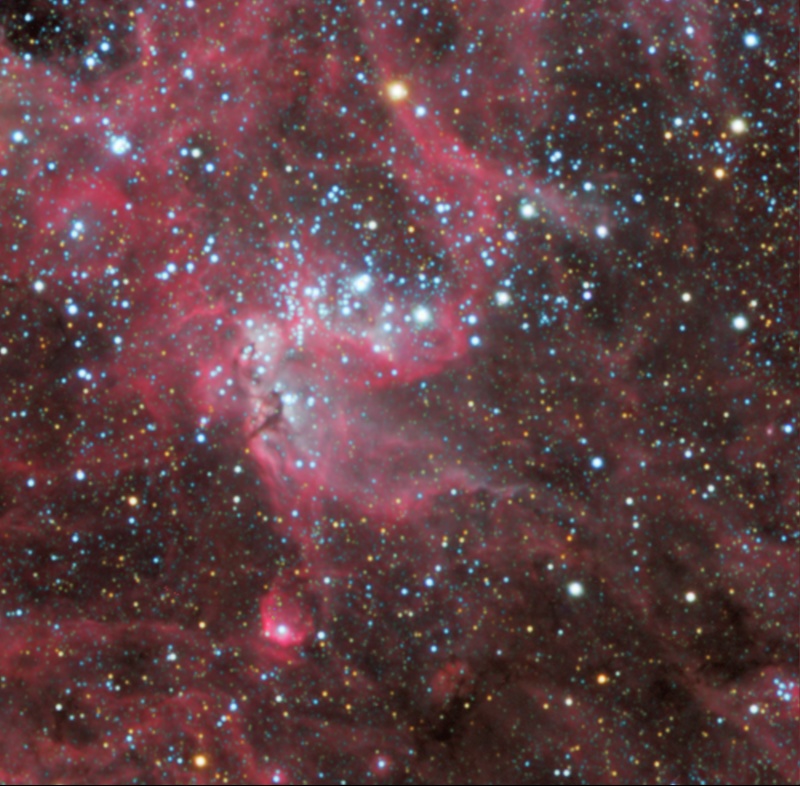

On Figure 1 you can see an example of the results that can be achieved with the algorithm described in this document.
![](1.jpg)
Figure 1— NGC 2074 HaRGB image obtained with the algorithm described in this article. Image processing performed in the PixInsight platform. Raw data acquired by Jack Harvey (SSRO/PROMPT) from CTIO (Chile) with a 16-inch RCOS telescope.

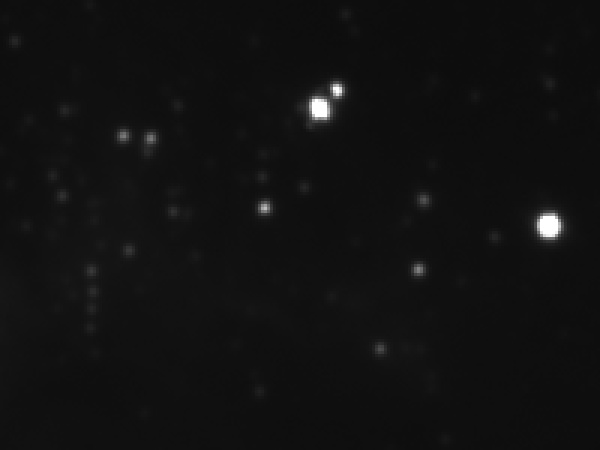

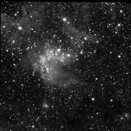

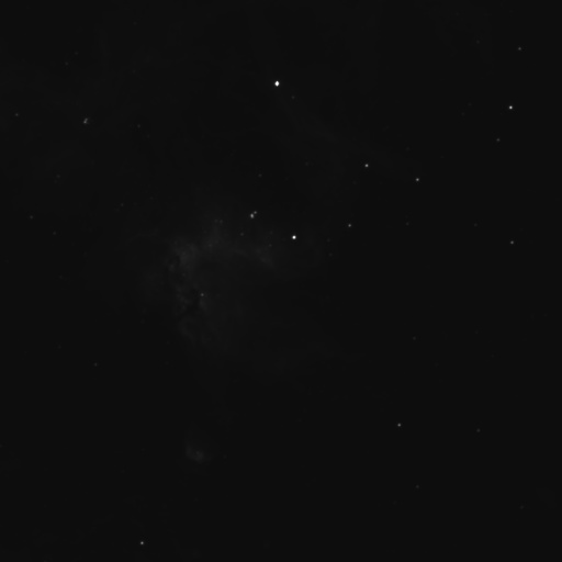

The original broadband data for this image is of exceptional quality. For demonstration purposes, a noisier version of the R image has been artificially created. As shown on Figure 2, a mix of synthetic Gaussian and Poisson noise has been added to the original linear image, which has allowed us to work with a simulation of broadband images acquired under more common (poorer) conditions.
![](2a.jpg)
Figure 2— Adding synthetic noise to the original linear red image.
Mouseover: [Original R image] [Added Gaussian and Poisson noise]

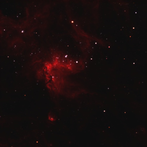

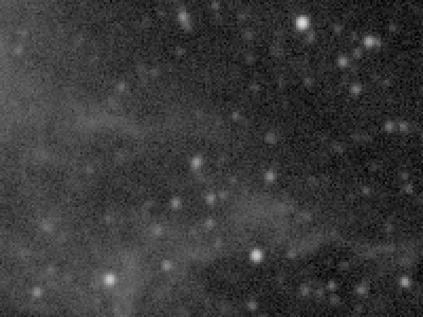

Several methods have been devised to combine H-alpha and RGB data with positive results. One approach consists of taking the result of a maximum operator applied to the H-alpha and red images. This operator yields the maximum value of each pair of pixels at the same coordinates. In this case, the maximum operator provides the correct star shapes and intensities, fixing well the luminosities of the fainter stars in the narrowband component.
![](3a.jpg)
Figure 3— Combination of the red and H-alpha components with the maximum operator.
[Maximum of R and
(H-alpha + 0.001)]
As seen on Figure 3, the maximum operator works very well to fix star intensities, but it has an important drawback: it transfers a part of the noise from the broadband image to the otherwise immaculate narrowband image. On the other hand, the maximum operator won't work properly if the brightness and background illumination level in the narrowband image don't fit perfectly to the same properties of the broadband image.

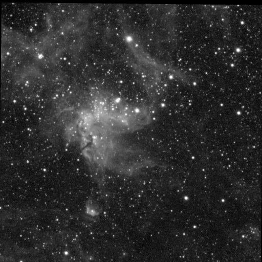

Another approach consists of mixing both images, usually taking a higher contribution from the narrowband image. We illustrate this technique on Figure 4.
![](4a.jpg)
Figure 4— Mixing the red and H-alpha components at different combine ratios.
Of course, this option is really bad as it doesn't provide a solution to anything: it doesn't recover the correct brightness of the stars, and it does degrade terribly the signal-to-noise ratio of the nebulas.

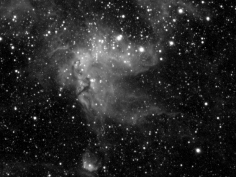

As we have stated before, our method avoids combining noisy broadband data with high-quality narrowband data. To this purpose, the first step is to generate what we call a continuum map. As the goal of combining broadband and narrowband data is to achieve a good chromatic representation for line spectrum and continuum spectrum objects, the key here is to learn which image features come from continuum emissions and which features correspond to line emissions. We can separate both types of emission by means of a simple division between the broadband and narrowband images:
C = B / N
where:
C = continuum map
B = broadband image
N = narrowband image

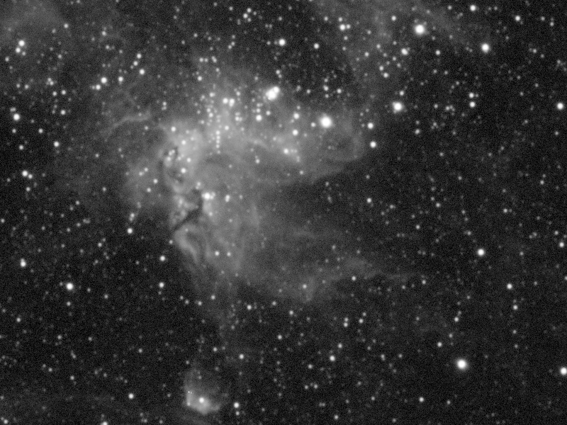

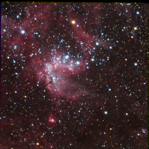

As you know, stars appear much dimmer in narrowband images than in broadband images. This is because a narrowband filter is transparent only to a small portion of the light emitted by these objects. But line-emitting objects, which only emit within the filter's bandpass, are not muted at all.
Following this relation between the broadband and narrowband images, we can separate both types of emission with high accuracy. The above division between both images will let us know how many times the continuum spectrum objects have been attenuated by the narrowband filter. The resulting image is a continuum map. Figure 5 shows an example, and Figure 6 shows how the continuum map is able to reveal really tiny stars inside the nebula.
![](5a.jpg)

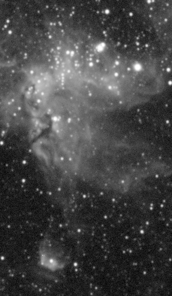

Figure 5— The red and H-alpha components plus the corresponding continuum map, with the same histogram adjustment applied.

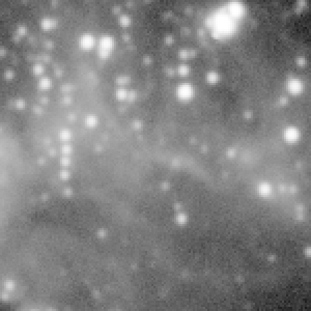

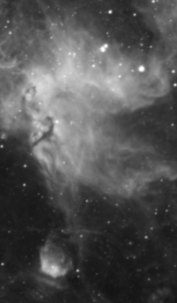

![](6a.jpg)
Figure 6— Same comparison as in Figure 5, on an enlarged crop. The continuum map shows many dim stars that were hidden by strong H-alpha nebulosity.

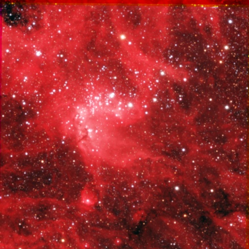

As you can see on both figures, the synthetic red image represents the best of both imaging techniques: good colors on the stars and high signal-to-noise ratio in the nebulas. Some of the nebular structures have less contrast now, but don't worry because this will be overcome in the next section.

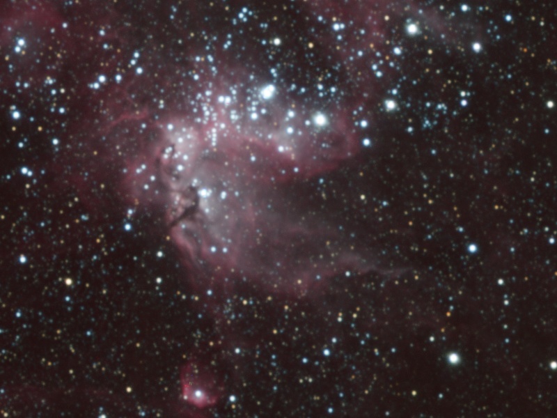

This synthetic red image will be used to create, along with the green and blue images, the RGB color composite. Pay special attention when comparing the resulting image to the original RGB image, on Figures 9 and 10. Finally, Figure 11 compares the results of our new HaRGB combination method, the maximum operator, and the channel-mixing combination method.
![](9a.jpg)
Figure 9— Original RGB image compared to the HaRGB image obtained with our method.
Mouseover: [Original RGB image] [Our HaRGB image]
![](10a.jpg)
Figure 10— The same comparison as in Figure 9, on an enlarged crop.
