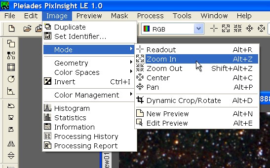

To select a navigation mode:

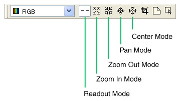

  • Image View Tool Bar
    The best way to select one of the five available navigation modes is to make use of their associated tool buttons. You'll find them on the Image View tool bar, which is visible by default:
If the Image View tool bar is not visible, you can show it with the Window > Tool Bars > Image View option of the main menu.
  • Keyboard Shortcuts:
    To select this navigation mode:
    Press these keys:
    Readout
    Alt-R
    Zoom In
    Alt-Z
    Zoom Out
    Shift-Alt-Z
    Center
    Alt-C
    Pan
    Alt-P
    Note that when an image window is the current active window in the main window's client area (you know this by its highlighted title bar), you don't have to press the Alt key to select navigation modes; for example, pressing the Z key is sufficient to select the zoom in mode.

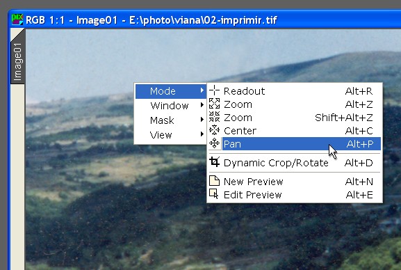

  • Image Window Context Menu
    You access this menu by right-clicking on any view of an image window.

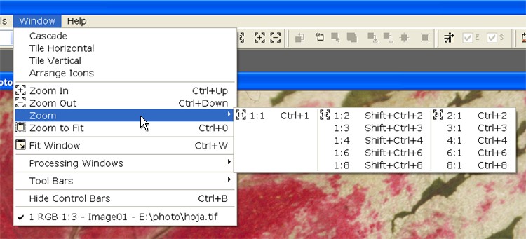

Zoom Commands
There is a series of keyboard shortcuts, menu options and tool buttons that allow you to quickly select a desired zoom ratio for the current view of the active image window. Zoom ratio is a local working parameter, that is, each view keeps its own zoom ratio and applies it for drawing itself on its 'mother' image window when it is selected as its current view.
Zoom In (Increment Zoom Ratio)
This command increments the zoom ratio of the current view. Maximum zoom ratio is 32:1.
Zoom Out (Decrement Zoom Ratio)
Use this command to decrement the zoom ratio for the current view. Minimum zoom ratio is 1:16.
Predefined Zoom Ratios
This comprises a set of commands that correspond to frequently used zoom ratios. This set includes: 1:1 (actual size); for magnification: 2:1, 3:1, 4:1, 6:1, 8:1; for reduction: 1:2, 1:3, 1:4, 1:6, 1:8.
Zoom To Fit
This command automatically selects the maximum zoom ratio usable to view the whole image. The selected zoom ratio depends on the size of the view and on the available space on the main window's client area, hence it is dependent on screen resolution and image dimensions.
If you use this command and the image window is maximized or minimized, it is restored before applying it.
Fit Window
This command tries to adjust an image window's width and height to fit exactly the contents of its current view at the current zoom ratio. This is only possible if the view can be seen entirely in less than or equal space to that available in the client area of the window.
Again, if the window is maximized or minimized, this command restores it.

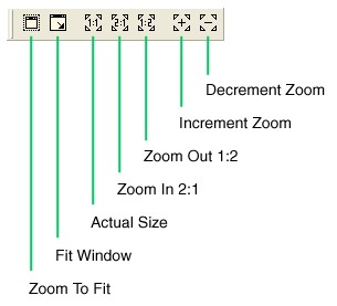

To Execute Zoom Commands:
  • Zoom Tool Bar
    This tool bar includes tool buttons to quickly access many of the zoom commands listed above.
The Zoom tool bar is visible by default; if it isn't, use the Window > Tool Bars > Zoom main menu option.
    To execute this zoom command:
    Press these keys:
    Ctrl-Up
    Ctrl-Down
    Zoom Out
    Shift-Alt-Z
    Zoom 1:1 (Actual Size)
    Ctrl-1
    Zoom 2:1
    Ctrl-2
    Zoom 3:1
    Ctrl-3
    Zoom 4:1
    Ctrl-4
    Zoom 6:1
    Ctrl-6
    Zoom 8:1
    Ctrl-8
    Zoom 1:2
    Shift-Ctrl-2
    Zoom 1:3
    Shift-Ctrl-3
    Zoom 1:4
    Shift-Ctrl-4
    Zoom 1:6
    Shift-Ctrl-6
    Zoom 1:8
    Shift-Ctrl-8
    Zoom To Fit
    Ctrl-0
    Fit Window
    Ctrl-W
  • Image Window Context Menu:
